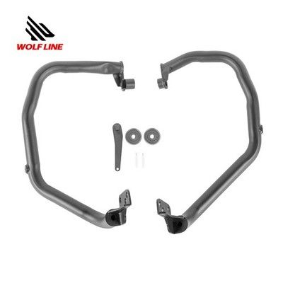

In case you missed it…
probably ok for casually dropping the rocket at a stop light or a parking lot but anything more than that and you ARE going to destroy the motorcycle and total it. this is the flaw with the rocket, the old gens are ok as the distance for the mounting is not as drastic of a lever as this. i would NOT put that on a rocket. Cast aluminum is NOT going to hold up well. every easy to snap them off for what? some paint protection.
IMO these are WORSE than nothing at all. learn how to ride is going to do more than this. ALSO rashed out back end
