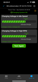

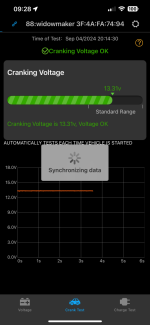

On any suggestions; the battery checks itself with wifi. It does a state of charge, charging test and cranking test every time you hit the button. I like how it will not allow you to hurt the battery, that safety switch has parameters for low voltage that wont allow damage, im not a lithium expert, all i know is antigravity protects your battery from death. As ive tried to kill it by not maintaining properly. The weight difference is enough for me, but the performance of this battery is also important as this forum proves rockets eat batteries, constantly click click, what could it be, i just bought a brand new battery as @mexican just found out. I replace batteries on eguipment proactively and try not to keep a battery until i get that very last start out of it. I use to buy powersport batteries ( mostly agm) for floor care equipment and have bought several bad batteries, in lead acid batteries cells charge from bottom to top, if a cell is damaged it will top load only, show good but not be worth a dime, i have zero knowledge what anti gravity does but the chip that constantly reads battery does what its supposed to. I dont do drop test on batteries but have rode a 34 mile snow mobile trail w @Sparky59 and bumbs rattling has had no effect on battery, broke me down pretty good though 😂.
