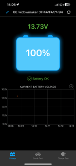

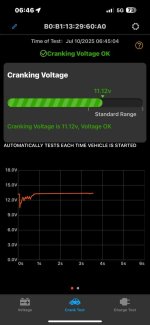

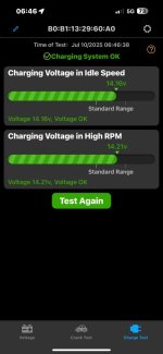

My Lithium-Ion battery experiences,
I have been running a lithium (Antigravity Lithium-Ion) for 36 months with no issues in my 2020 Rocket 3R.
Desert heat 115degF, cold starts in 32degF weather. Rocket has set for two weeks, starts right up.
I have a battery monitor from Antigravity monitoring the battery status.
The only concern is the battery voltage dropping below 10.0 volts as this is approaching the point of battery failure.
Antigravity Monitor is connected thru bluetooth, battery status alerts me with under voltage,
charging voltage over/under ect.
LiFePO4 works fine in the Rocket 3. The Rocket outputs the same voltage range as the Tiger 1200, which comes OEM with a LiFePO4. A voltage between 13.8 and 14.6 keeps both types of batteries charged.
Beyond that, any decent LiFePO4's BMS will prevent a variety of battery-killing conditions.
