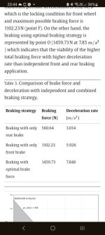

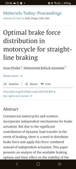

It looks about 66%F to 33%R breaking force...
