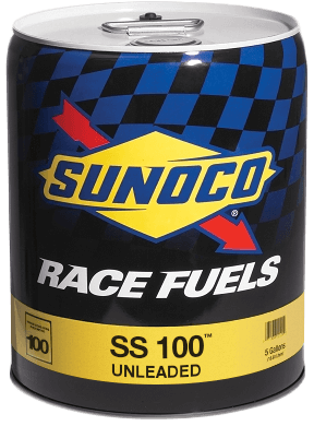

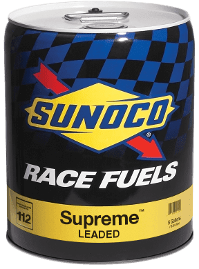

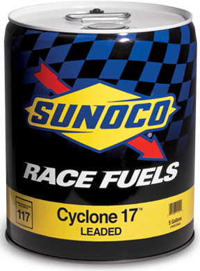

That's sad. Sunoco offers racing gas in 5 gal cans of any flavor you need at our local station. But at about $10 gallon I'll pass. I used to go to the local airport and buy a drum of leaded aviation gas to run in my '67 Firebird when it had the 12.5-1 compression pistons. It was clear gasoline at the time. But I think it is now dyed.
Fuel Selector - Sunoco Race Fuels
112 octane - blue
117 octane- light red
100 octane unleaded not dyed street legal
