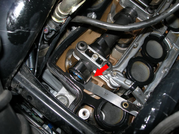

Valve clearance adjustment must be carried out with the engine cold.

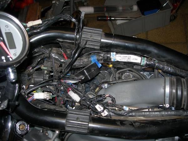

1.Remove the fuel tank .

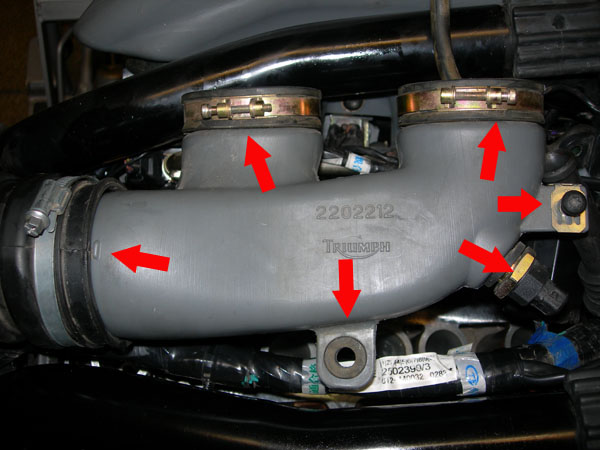

2.Remove the intake duct.

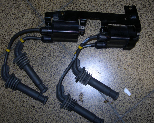

3.Disconnect the spark plug leads from the spark plugs then remove the coil brackets with the coils attached

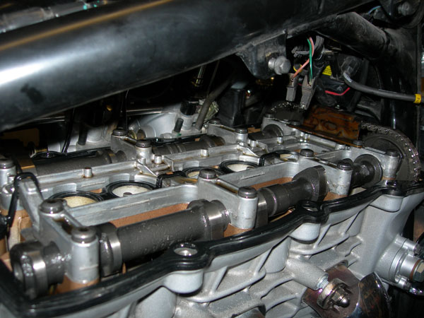

4.Remove all the bolts and bolt-seals from the cam cover.
5.Raise the cover and manoeuvre it towards the right hand side of the engine.
6.Remove a spark plug from each cylinder to reduce compression resistance when turning the engine.

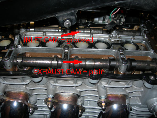

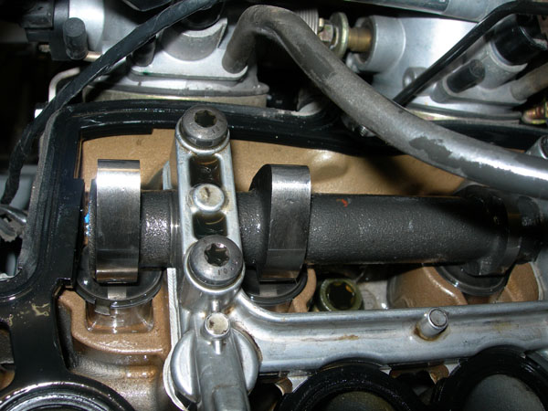

7.Select a high gear and, using the rear wheel, turn the engine over
until a pair of camshaft lobes are positioned pointing directly away from the valves.
8.Correct valve clearances are in the range given in the table below.
Inlet 0.10 to 0.15 mm
Exhaust 0.15 to 0.20 mm
9.Using feeler gauges, measure and record the clearances for this pair of valves only.
10.Repeat the process until the clearances for all valves have been checked.
11.If any of the recorded clearances fall outside the specified range, adjustments must be made.
12.If all measured clearances are within tolerance, refit all.
