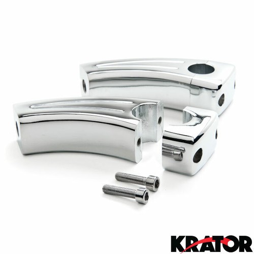

Hello touring crew :) Searching and searching for risers and coming up with nothing that fits the 1" up / 2" back set up that is supposed to fit the touring without changing cables.. My back is killing me and I don't want to ride! Since rivco disc them, who's the new supplier? ALl I keep finding is Krator 3.5 that is supposed to be compatible.. Here's the link to the krators..will these fit you think?
I put the Krator risers on my Speedmaster . The top triple clamp needed to be drilled out to 1/2" to accept the bolts. The Triumph holes are for 12mm studs which are a few thou smaller than 1/2". They seem to be decent quality.
Hey warp.. Ya these are 5" high though so wouldn't my cables need to be extended?
