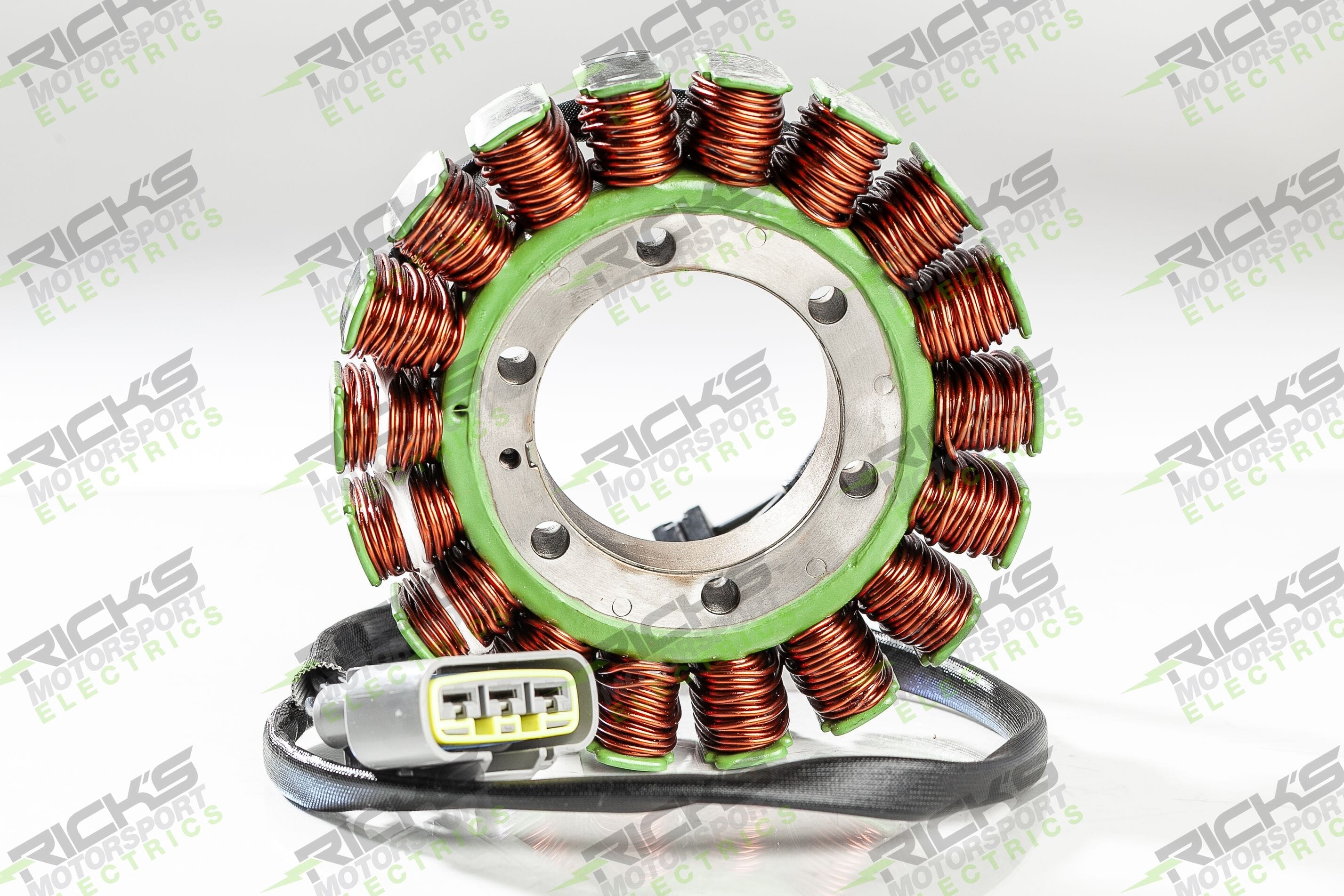

If you do choose to replace look at RicksMotorsportElectrics rather than OEM
Fits early R3's no change since just haven't updated their website.
US$225
NEW OEM STYLE TRIUMPH STATOR 21_021
