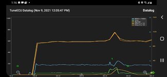

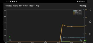

Was tired of recording with no results. Took short ride yesterday with less than 1/2 tank. Bike not in sun and it stalled. 😒Maybe not 1 reason for stall.
Will take a ride today and record but don't expect stall. Tomorrow dealer gets it. Will explain to manager all of us with stalling.
SCORE! Got stall recorded. About 20 minutes after fill up. Almost a second one few minutes later as revs went to about 500. But no red oil can! Only 83 degrees outside. No consistency. Dealer will get recording. Drive to station, got water and I stopped recording. Started again toward home. You see 2 separate recording times ( not Nov. 6)Stall is the later. On phone you would swipe left to see entire event.
