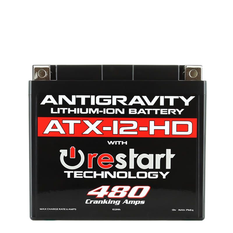

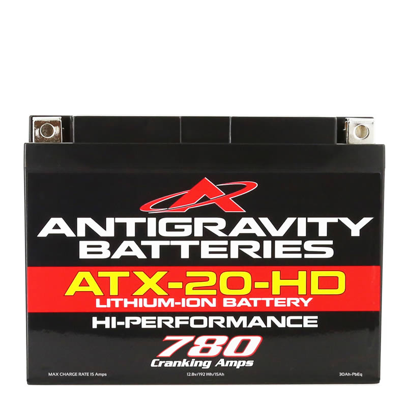

AntiGravity (my goto choice) has an 8ah that will fit
But even that is effectively much less reserve than the stock battery. They make a true 15ah that will fit, but only if you put it on it's side and extend the factory battery cables, which for some reason I'm just hesitant to do (one more thing to go wrong and leave me stranded
