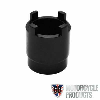

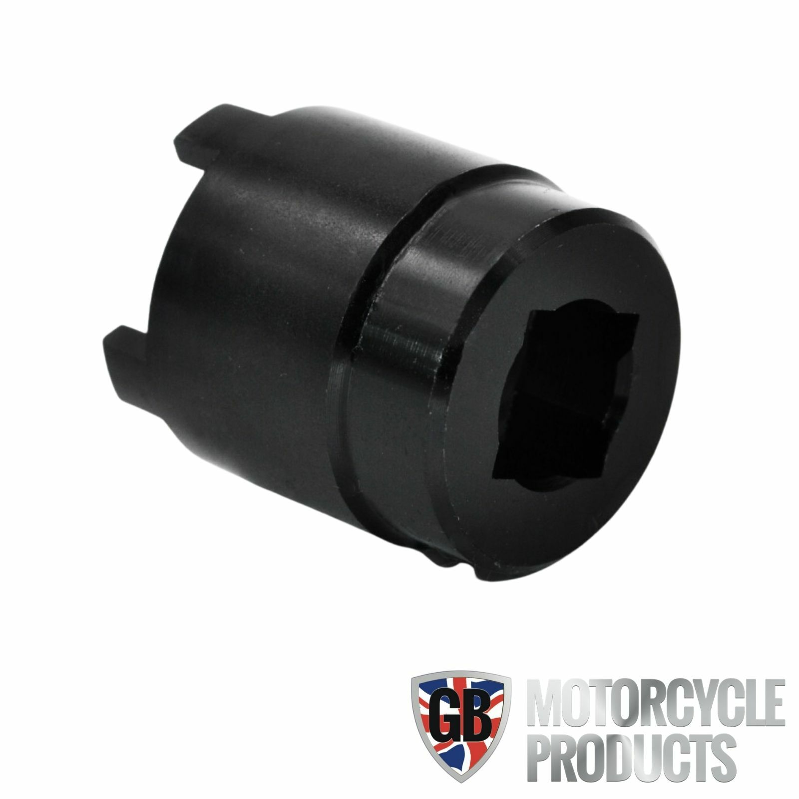

Triumph Socket Tool Pt No. T3880062
T3 WRENCHLOCK RING 38M​
Price: GBP 17.38 Approximately AU $32.25

The manual also calls for this tool (Triumph #T3880062)
$38, and how much you want to bet no one has it in stock?
I'm pretty sure I read on this site where someone showed how to make one from a socket, but I can't find that post. Anyone have any ideas?
