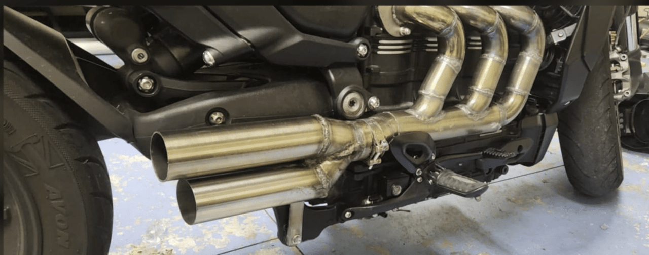

sunny Supercharged Joined Jul 17, 2021 Messages 467 Ride Rocket 3R LIMITED EDITION Apr 26, 2025 #11 I made third slipon this week ( I need to do some cleanup on welds though) 2.5inch tubes x 2
Idaho Red Rocket 3 Living Legend Joined Nov 22, 2008 Messages 6,293 Location Nampa, Idaho USA Ride 2006 RIII Standard Bagger w/Fairing Jun 11, 2026 #12 I beleive a longer pipe assists in acheiving higher torque numbers.
Gerald Nitrous Joined Dec 14, 2018 Messages 1,053 Location Lou. Ky Ride 05 Rocket III Jun 11, 2026 #13 Idaho Red Rocket 3 said: I beleive a longer pipe assists in acheiving higher torque numbers. Click to expand... Need to go to dyno with long pipe/collector and keep cutting the length until you reach best numbers, and keep an eye on fuel ratio numbers.
