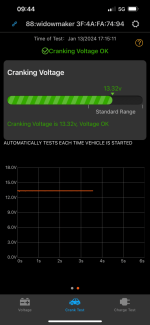

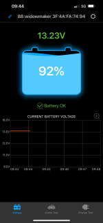

, mine does this after 6 years. This is new 2500 battery YTX12-24 Hi-Power Lithium Battery the new rockets use a different battery than the old models. Yours dropping to 9.4v tells me if its not what turbo suggests then the battery is just not heathy, dead cell possible, and top loading meaning bike thinks battery is full when charging but battery actually doesn’t fully charge. When youre running what are the voltages doing at idle and at 3000rpm ? Batteries gave me fits before i bought the 900 cca beast from antigravity, this winter it was torture tested, outside in a truck for a week in freezing conditions tuning and it did great.

Kevin, my screen shots are from a fully charged battery that was only 4 months old (the OEM AGM Yausa battery). Based off my screen shots I convinced myself (and Revzilla) that the battery wasn't able to source enough current and got a warranty replacement. The new battery behaves in exactly the same way.

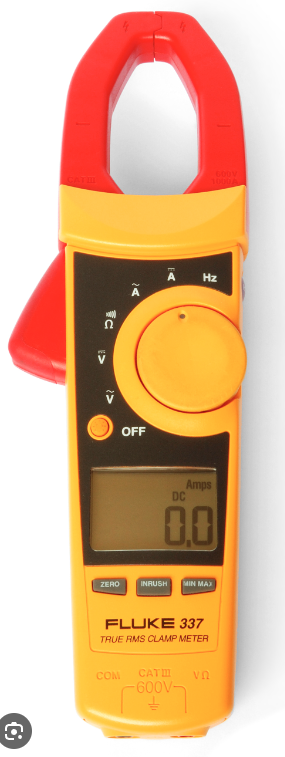

verify with someone else cranking amps, I have this DC amps meter, I can measure cranking amps if that is going to help you but then you would need clamp meter to measure yours(?)
yes please measure for the forum, others will come across your post as well and it would be nice for information gathering.
