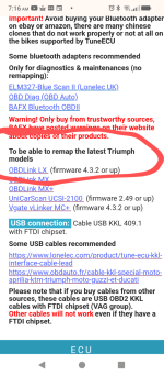

This is from the basic guide for the Android version on Tuneecu.fr, bikes list: read and write USB only
So I read that wrong :(
I have to get a cable. I guess I'll be waiting a while for the correct cable to get to me, unless someone has one they can recommend , that actually works that's from Amazon

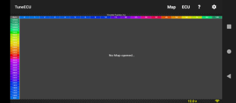

I did see a way to view the current map. When I scrolled to the map part of the App, it just showed it as blank

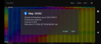

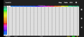

I just attached the Bluetooth dongle that I got this morning. Obdlink LX
It now shows maps, and that I can change them?
I opened the map that says it's for my bike, stock configuration.
I'll include screenshots for what I did

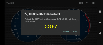

I also checked the TPS setting and the ISCV setting, and the TPS was same as last night (obviously I didn't work on it when I was asleep) but the ISCV setting changed a lot. And when I was watching it on the screen it would fluctuate from the 500's to like 800. I wasn't touching it at all, just holding my phone staring at the bike.
Could the ISCvalve be faulty? Faulty valve would explain issues im having. . .
