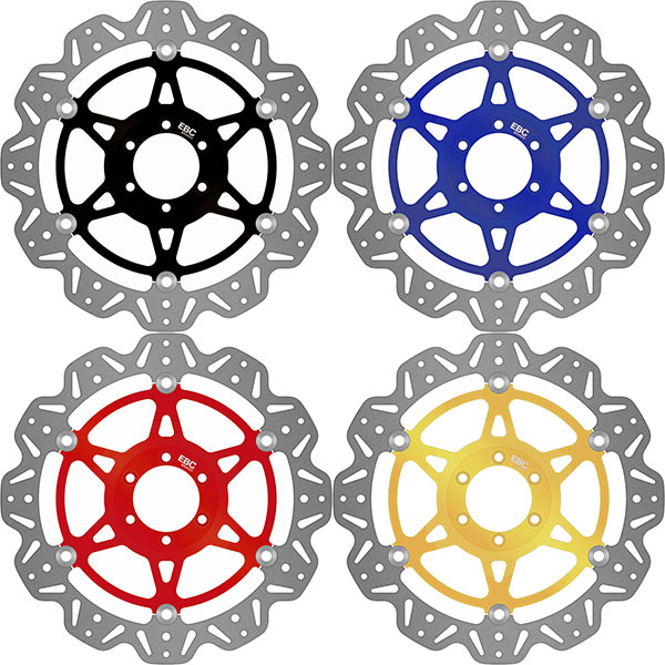

I have new ebc vr669 disc one red one black 🤷🏻 im needing a front set of disc for touring. Do your homework on fitment, as they fit, daytona, speed triple, others, maybe just a track day settup on classics, roadsters, and im not sure about abs but they list for alot of years. Im looking for touring disc to use at track only, dedicated rim, so used is fine as i plan on ruining them😬

Was their a fitment issue with the EBC ones?
They are supposedly for
EBC VEE BRAKE DISC VR669 BLACK FRONT TRIUMPH ROCKET 2300 III CLASSIC 2006-2009, but released in 2013?​
I'm not sure what if any difference to Rocket III Std/Classic/Roadster front disc T2028500 as both 320mm
Maybe just color of center or drilled hole pattern which is not evident from identical parts images.
They also both use the same bolts and the little thing #12 appears to be a finishing plug no longer available or it comes with the bolt.

EBC Vee Brake Disc Vr669 Black Front Triumph Rocket 2300 III Classic 2006-2009​
Product Description​
Full Floating Vee-Rotors offer an exciting new lightweight rotor with an exciting range of color options. Features EBC's square sided drive button system to completely eliminate the chance of rotor warping, extend rotor life, and improve braking consistency. The braking surface is made from heat treated stainless steel and tempered back to the optimum hardness. EBC has worked long and hard on choosing the exact correct hardness and temper procedure for their brake rotors. Under hardened rotors will wear out prematurely, while over hardened can crack over time.

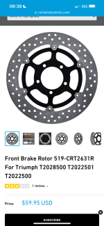

Wow, these seem a great price! BUT I would ask the questions raised by a review
OEM states minimum thickness of the rotor to be 4.5mm. Niche rotors arrives brand new at 4.5mm."
and their claimed 7.5mm in product description which seems over thickness of stock new from memory of 5.5mm or 6mm.
I know of mechanics who say they are fine down to 4mm.
Price:
Sale price$59.95 USD each.

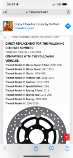

Front Brake Rotor 519-CRT2631R For Triumph T2028500 T2022501 T2022500​
Description​
519-CRT2631R Front Brake Rotor Product Info:​
  • Rotor Profile: Plain
  • Outer Diameter: 316mm; Thickness: 7.5mm
Direct Replacement for the Following OEM Part Numbers:​
T2028500, T2022501, T2022500
Compatibile with the Following Vehicles:​
Triumph Rocket III Classic Tourer 2-Tone: 2008-2009
Triumph Rocket III Classic Tourer: 2007-2011
Triumph Rocket III Classic: 2006-2011
Triumph Rocket III Roadster ABS: 2015-2018
Triumph Rocket III Roadster: 2010-2018
Triumph Rocket III Special Edition: 2006
Triumph Rocket III Touring 2-Tone: 2011
Triumph Rocket III Touring ABS: 2012-2017
Triumph Rocket III Touring: 2008-2017
Triumph Rocket III: 2006-2018
This was a set of actual SUNSTAR branded ones R3T already sold by MotorTech wreckers but with great pics
Niche is jacked up on there disc listing, has 3 part numbers for same disc. 2500 being for touring and the other 2 are for classic roadsters, i cant order this knowing they are not the same and will not fit the touring. Im ok with there quality, but 3 part numbers for same disc dont fly, as these will only be used at track for emergency braking😎
