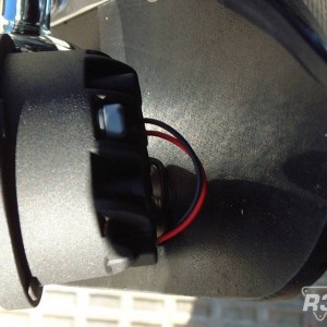

Here canted by 20º
Link Removed
Note canting l/r also results in outwards cant.

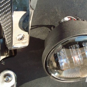

Bracketry
I have home made air deflectors made from 3/8" (10mm) Kevlar/nomex sandwich - I made a triangulating bracket out of 4mm thick steel.
The curve is NOT optimal but I had to clear the Oz-Claw on teh left - so the right one matches. (sorry - it's not a great photo)
