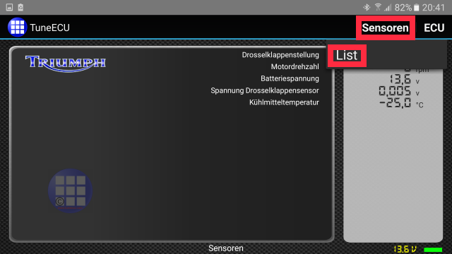

You need to go the link i provided earlier and read it:--> Android TuneEcu Information
pay special attention to the bottom of that webpage and read the information about how to record the sensor data

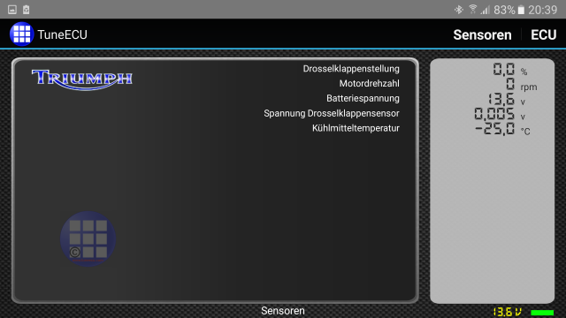

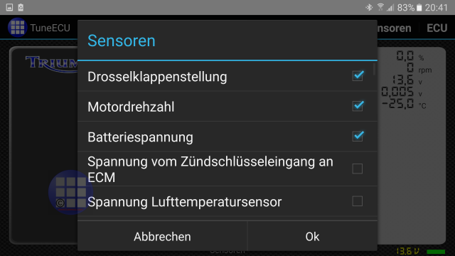

Sensor Screen:
In the Sensors Screen, all sensors in the bike can be checked for their values.
It can be selected via a submenu, the sensors whose values you want.
Sensor data recording:
- Click twice on the "REC" button (or do a long press for Android version 4),
it must turn green and the red dots must appear at right of the values.
- Select your bike and connect. When datas are recording, the "REC" button turn red.
- The recording is stopped by a long press on the "REC" button again.

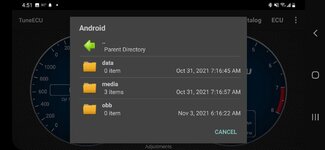

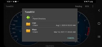

A Datalog file is saved in .csv format in the "TuneECU/Logs" folder on your Android device.
This file can be played in the Dashboard Screen or opened and viewed in a screen.

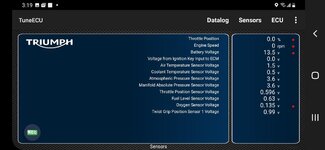

Question. The sensor screen had 4 parameters already checked to record. I checked everything. Maybe 20. Instructions said recording button turns green and at right of each figures should show red dots. Why only the 4 and not all? Maybe those 4 are the only ones needed?
