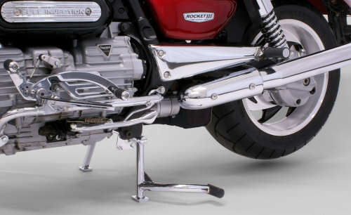

RIVCO center stand #TR3001
I bought a never fitted unused RIVCO. The unit comes with the instructions and required bolts and adjusting shims to cover model and manufacturing variances.
Fits pre 2010 R3 Std and Classic models.
These do not fit the Roadster or Touring models.
Only Rockets without ABS as the ABS unit is in the way of the center stand spring and spring brackets. I had a suspension fitter look to fit it to my 2010 ABS Roadster and he said I could have the brackets cut off and re-welded about 20mm to one side and it should then fit a Roadster. They are a beautiful bit of well made and chromed kit but I have various lifts and jacks for maintenance now.
I believe they are out of production and they never made a Roadster or Touring version but there is a US site that still lists them.

WILL NOT FIT A 2009 CHASSIS. These came with the dual 8mm holes. Guess how I know :mad: - one year I'll finish modifying mine to fit.
What came with 8mm holes the 2009 chassis or the RIVCO centerstand? I think you mean the chassis. This was a similar issue with @Sidecar Flip 's Flipmeister's Speciality Products servicing center lift where he sold a 1/2 " drill bit with some to drill out the chassis from memory.
Yep. It looks like it may be late 2007 on models with the smaller diameter through holes that need to be drilled out with a 1/2 " drill.
They will still fit then though.
Signature Products | Flipmeisters Specialty Products
Late model R3’s, built after late 2007 with through holes less than 1/2″ (13mm) (0.500″), the through holes will require drilling with an ordinary twist drill to the required dimension of 1/2″ (13mm 0.500″). Prior to ordering, please check your lug hole dimension to insure that it is 1/2″ (13MM). If the lug boss holes are smaller than 1/2″ (13mm) please order the late model stand with 1/2″ drill bit included if, you do not have the required drill on hand to enlarge the lug boss holes.
Late model R3’s as well as Touring, built after late 2007 with through holes less than 1/2″ (13mm) (0.500″), the through holes will require drilling with an ordinary twist drill to the required dimension of 1/2″ (13mm 0.500″). The required 1/2″ (13mm) drill is included with this Paddock Stand.
The Chassis has 2 * 8mm holes . BUT - though it may work with the Flip's stand - DRILLING OUT is NOT an option - the frame lugs are a different shape. The frame sits into recesses in the rivco. The recesses are different shapes to the lugs. These are actually what take the weight not the bolts.
