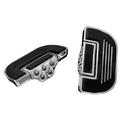

I found the KURYAKYN Premium and Ribbed Floorboards 16210557 in the storage yesterday, they have the splined rear adjusters for RIII pillion pegs with them.
They can be positioned in 5 locations using the standard peg mount bolt to suit the pillion.
Same as these but mine have the adaptors sold separately for up to a $100.
Switching to floorboards just got easier and with five thoughtfully placed splined mounts, these boards can be fine tuned just right for the rider or passenger. Style Premium. PRODUCT DETAIL Provide style, quality and function.
