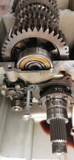

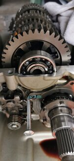

Hello, does anyone know what's the correct position of the bearing?
Photo 1 or photo 2?

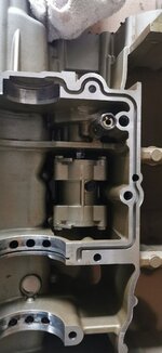

As you can see in the photo no 3 triumph designed an channel in order to allow oil getting to the bearing... But when I have split the cases the bearing was in position from photo no 2. I don't think oil will get to the bearing since is sealed on that side.
Any advice?

That bearing looks like it's on the front portion of the output shaft just ahead of 1st gear. According to parts breakdown, the bearing shield should point as Kevin stated... pic 2.
