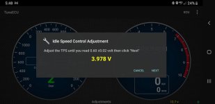

I did the adjustment
It was at 0.591 at rest, dis the prosses and set it to 0.679.
Screenshot_20230818-174447_TuneECU.jpg Screenshot_20230818-174752_TuneECU.jpg
Now the part that disnt match what you said, at full twist of the throttle it is 4.0 volts of I go hard enough. Screenshot_20230818-174803_TuneECU.jpg
i tried twisting the throttle as slow as i could and the voltage read out is very smooth. I did it quite a few times. Nothing jumpy at all.
I did this twice and the 3rd test it stayed at 0.679. With 0% throttle
No change in the problem.
I dont want to waste $140 bucks if this part is still good.
Why would this tps issue be only in 2nd gear and not in all gears?
Maybe i did it wrong, now that im reading up on this, i was adjusting the right thing, BUT the write up is misleading to what i am doing! What do you mean by 0.68v when "OPEN"
