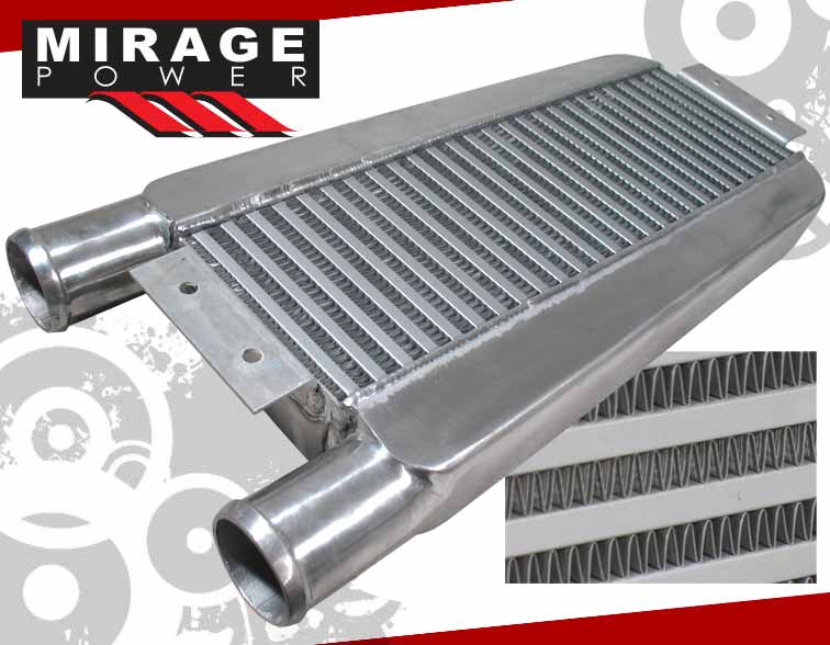

Regarding intercoolers, there is a LOT of misinformation out there, people who understand some of the theory but not enough of it. The most important dimensions are forward facing area, the least important is thickness. The more forward 1/2 of the intercooler does 3/4 of the cooling, so by doubling the thickness you can get some more cooling, but if you instead increased forward facing area by double you'd get vastly more cooling power.
Then there is the type of end tanks, the most commonly listed and sold ones are garbage. 1st image is what you usually find for sale, 2nd image is the better type. Second type has a lot less pressure drop and is more efficient at cooling:
