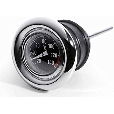

There were two versions of the Triumph factory accessory that fits in and replaces the stock chrome oil tank plug.
An analog and a digital version.

The much, much cheaper Harley ones from China eBay are much cheaper and just as useful.
You ain't gonna being checking the temp while riding! ;) :roll: :roll: :roll:
I have one in my Roadster and you need the Sportster fitting model from memory but I have posted details on the forum before.
Harley Davidson oil temperature gauge available with Black or White dials
