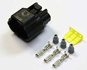

The point is I'M sure they're going to be bog standard connectors from SOMEBODY - and I doubt they're THAT special. Almost certainly a "generic" version of something else. The Headlight loom connectors for example I've found - Intake Air Temp as well. If I can get an example I'll get round the BIG stockists and see what's there. I think they MAY be "Econoseal".
I'm VERY interested in a source for the common ones...i.e. headlight look, heated grips, etc and have no problem with a reasonably sized order
HEATED GRIPS - Confirmed - Amp(henol) Econo-seal 3way
Confirmed by Eastern Beaver btw.
http://www.easternbeaver.com/Main/Elec__Products/Connectors/Sealed/Econoseal/econoseal.html
http://www.thetoolboxshop.com/0-012-53-econoseal-3-way-waterproof-female-connector-2462.html
Of to scour the web - tbh I think we'll find that the clock and lights are similar. I'll drop under the tank over the next week & order various types just in case.
