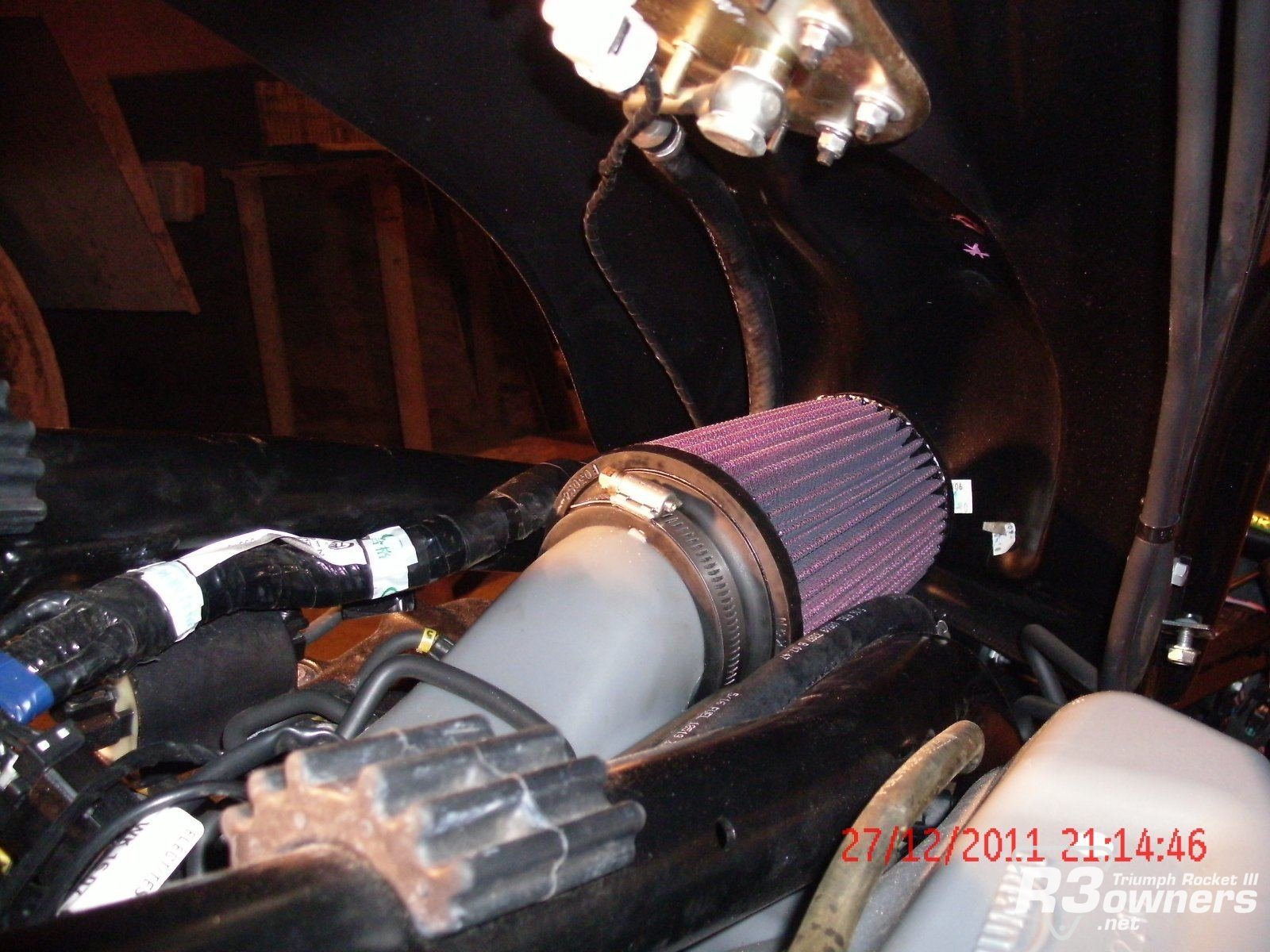

    To answer your question with a short answer, yes, unless you put the K&N RU-5111 under the tank*, that doesn't make enough of a difference to airflow to warrant a remap imo.
    *I assume this works ok with the Touring tank too, perhaps someone can confirm.
    As an alternative suggestion, if you're just looking to fit a fusebox somewhere and do no more, I've one under the left side cover (for constant 12v supplies), also one under the right cover for switched 12v supplies.
    But I would endorse moving air filtration elsewhere 'anyway' just to free up the stock airbox for toolkit, puncture repair stuff, jazz mags, etc.
