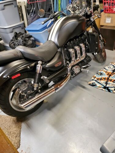

Hello, It's been some time since I've been on here. But now that I'm tired of my stock exhaust but don't want to spend a ton on a completer system. By the way, I already have installed ramair intake.
Has anyone here used this before?
Would this slip on exhaust be similar to tors when it comes to tuning? HansO has this tun for the roadster and if I get this slip-on, would it work?

I'm also looking at this outlaw exhaust. Which would work best with the tunECU maps that we have? I have everything listed in the map above but the exhaust.

Could someone tell me if a slip-on exhaust, (like the ones in my original post) would be equal to or close enough to the tors so I could use one of these maps?

Should be really close.
I run D&D slip-ons and they are close to TORS. I've been running the "R3T_Stock_or_Slip-on" tune since '14 without issue.
