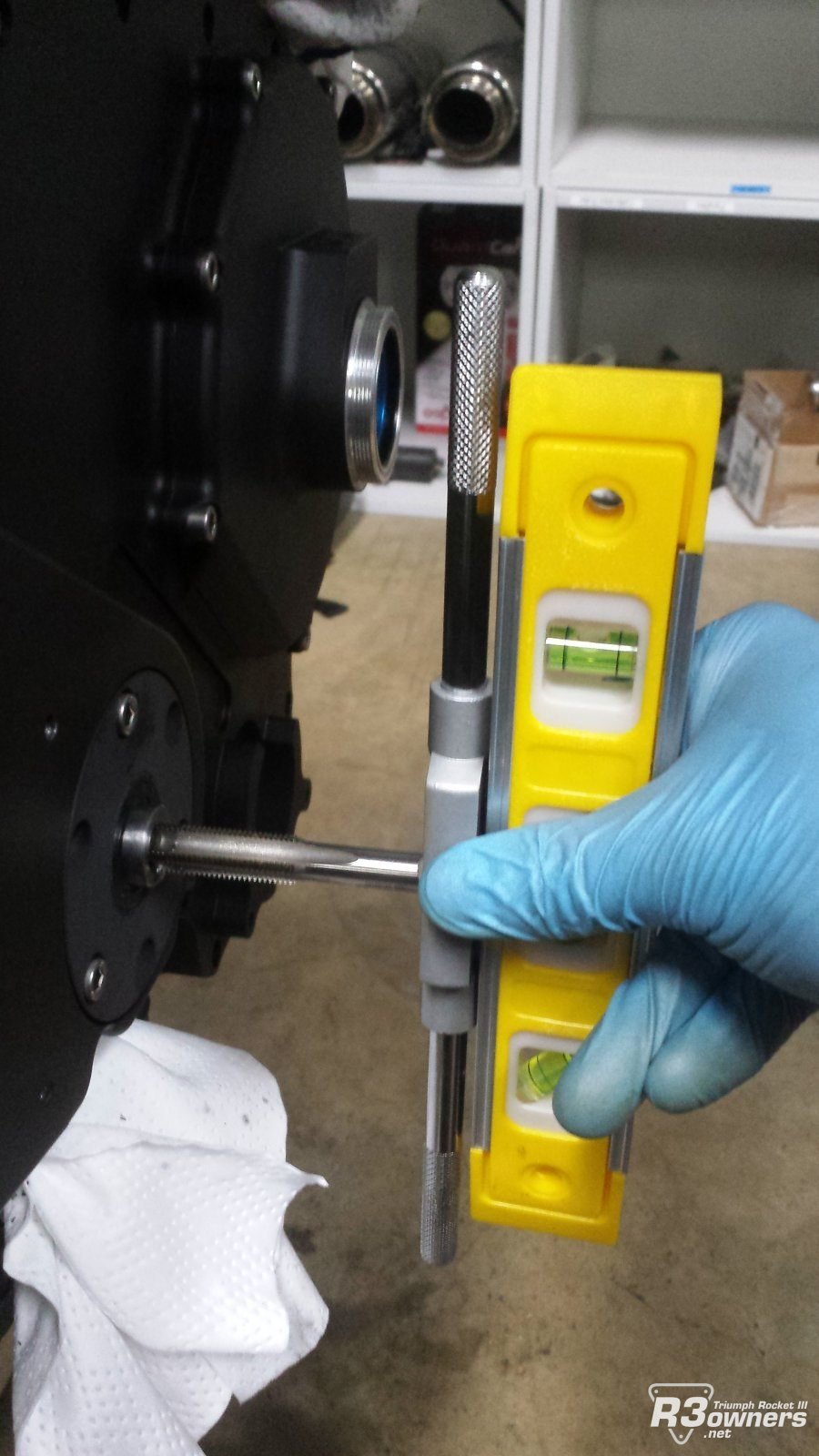

I decided to go for the stage 2 kit which arrived a couple of days ago from TTS.
After reading the fitting instructions it looks like the first most important thing is to keep any swarf from entering the engine.

Doesn’t it come with a fixture to align and limit depth of the crank drilling? Thought I read somewhere that is included now.
Hi,

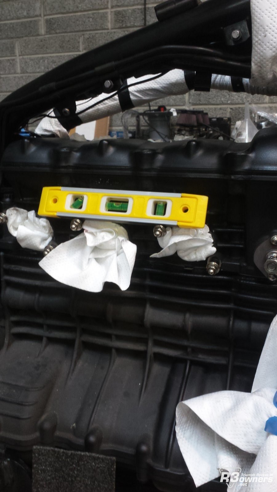

There are two guides that come with the kit.The first is to drill the crank and the second is threaded to guide the tap.
These i think are to ensure that the hole is drilled and tapped horizontally.You still need to measure the depth of the hole.
Cheers Ant

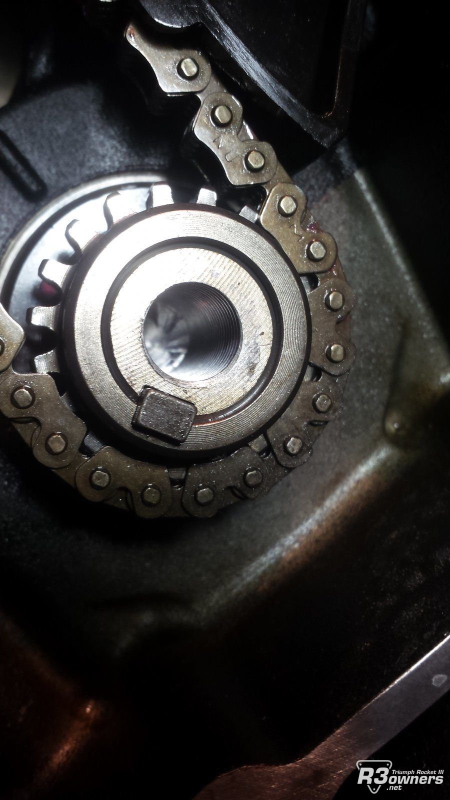

Wow...Having to drill a perfectly centered hole in the end of the shaft to a precise depth outside of some sort of fixture is a real challenge. Even under the best of circumstances drills have a tendency to wander a small bit. An amazing job to have to do.

Just thought i would give an update of the supercharger fitting.
I spent half the day drilling and tapping the thread for the crankshaft drive pulley.It is something i would not want to do again although
i am really happy with the end result.TTS forgot to mention the use of the bottom tap in the instructions but that is why 2 taps are supplied
in the kit.
