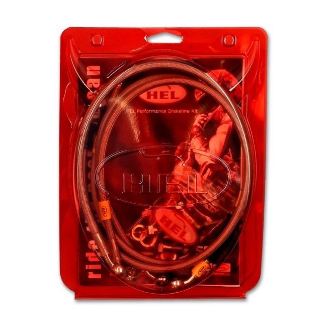

What did you replace the stock brake lines (tubes) with and did you replace all six (6)?
Factory stock lines are actually stainless steel under the rubber covers. I am not a mechanic or plumber re hydraulic pressures but the HEL aftermarket stainless steel brake line kit I have for the ABS R3 has six (6) brake lines of various lengths with the short ones being ABS component related.
Did you change ALL of the stock brake lines?
Could mixed and possibly different inner line diameters between factory and aftermarket lines affect the ABS design volumes and pressure calibration?
https://www.cj-motor.com/assets/full/HEL335-6-HOSES-HBF8014-.jpg?20200624033445
SKU: HEL335-6-HOSES-HBF8014-
HEL BRAKE LINE KIT FOR TRIUMPH ROCKET III ROADSTER ABS (2011-2013) 6 HOSES​
Part Number: 6 HOSES HBF8014​
