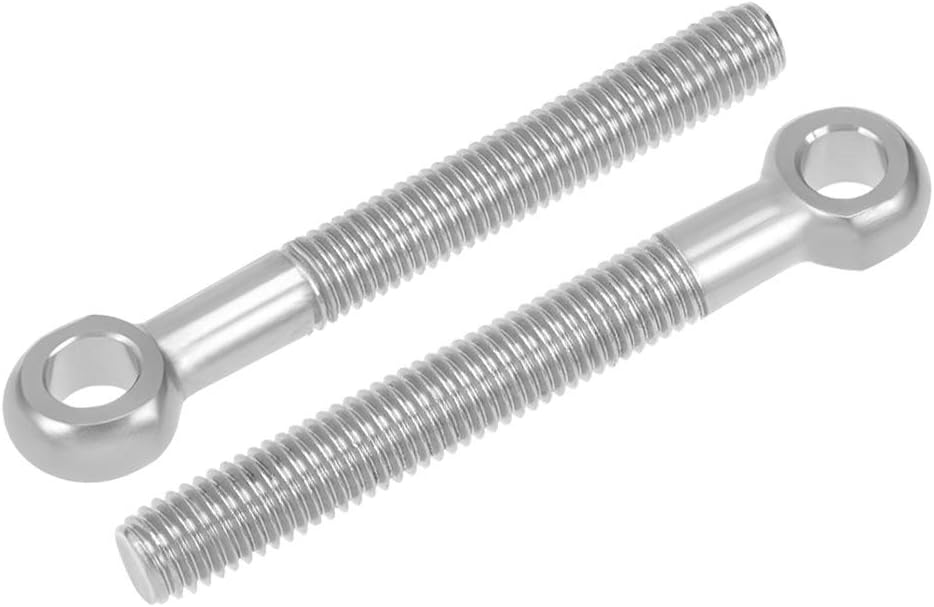

I got these for when I wasn't using my saddlebags to have tie down points for a luggage rack. Looked good and worked great. Add SS nuts to stop from turning bolts all the way in.
