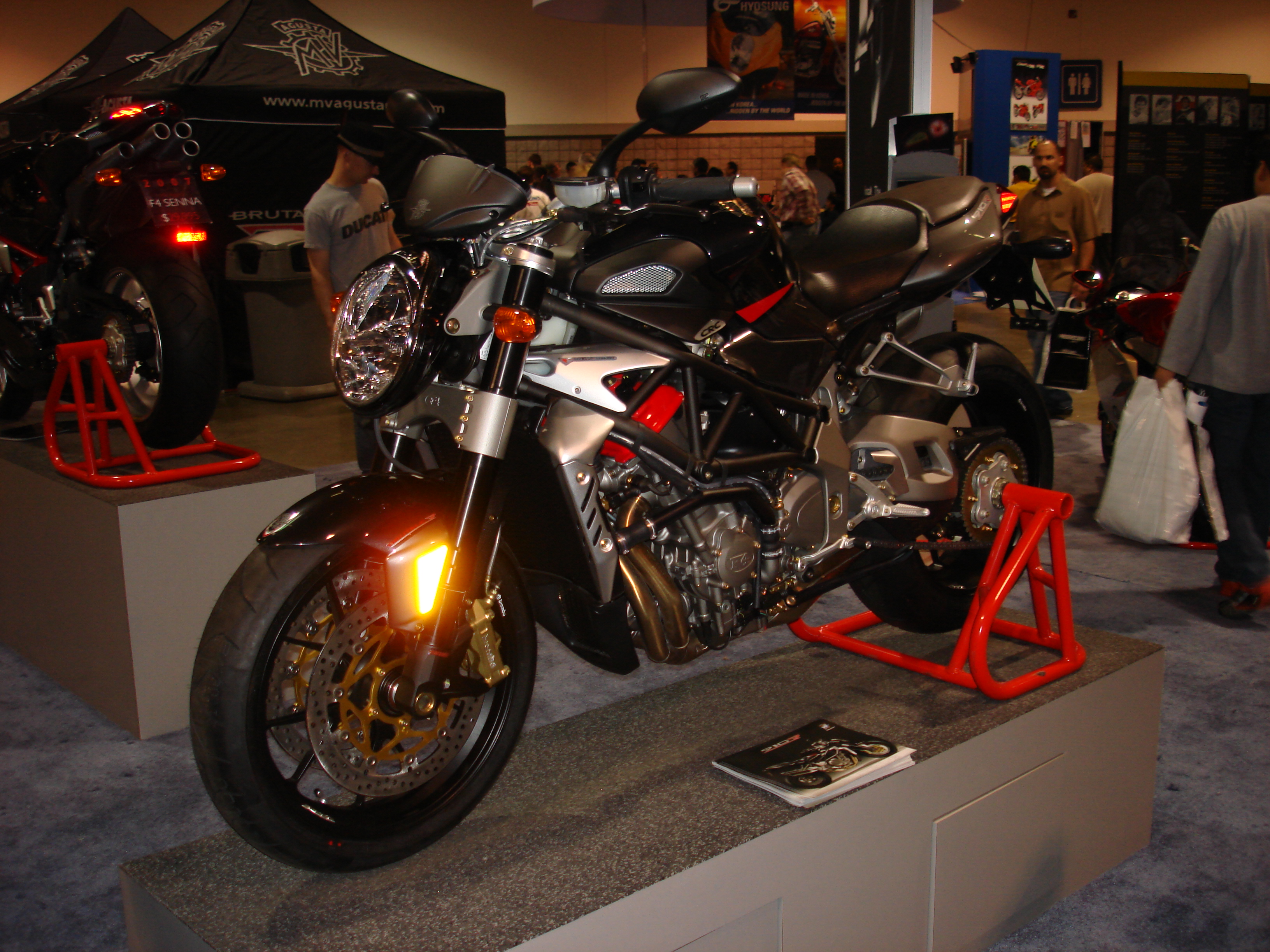

I've run a front carbon fender in the past, and will again in the future. If there was any additional front end flex, I couldn't feel it, at any speed. Keep in mind we have, the biggest USD forks ever made, and the befiest factory triple tree's I'm aware of made by anyone.
Now that I really think about it, I've never had any chassis flex that bothered me in any way on the R3, except that motion generated by a too loose steering bearing. Even cranked over, power on in 1st, hovering the front tire it stayed solid and predictable.
Keep in mind we have, the biggest USD forks ever made, .
Debatable.
The outers are indeed beefy But the inner tube is only 43mm. As we all know big thin walled tubes are stiffer than than a thinner one with fatter wall.
And the early Brutale's had some serious lower yokes.
