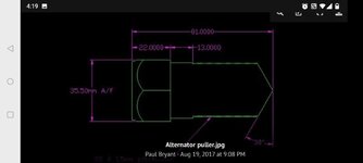

I do have the drawing for alternator puller. Thanks to Paul Bryant
