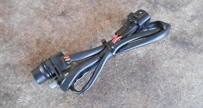

not likely the sensor
u can look at the sensor check for cracks/wiring and make sure the rotor is not bent
it can be checked at the ecu with a scope and wheel turning
more than likely the prob is the speedo head
