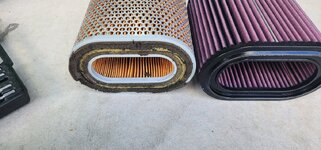

So this thing had the original filter from 2009 still in it. Not expecting a performance increase but it was way past its life. Foam just crumbled. Got 1 of 3 major bushings out. Either need to cut the last 2 or find a hydraulic press. Axle is still being dumb.

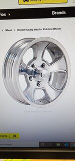

This looks like it matches the bike pretty well. But it only comes in 1 offset so I may need to compromise with something else. Need everything for mockup first. I hate these shipping timelines.

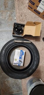

Minor progress on materials. Got the 2k lb trailer spindle, idler hub, tire, and paint gun. I can start cutting up the swingarm soon then mock up tire to test fit for wheel backspacing.
