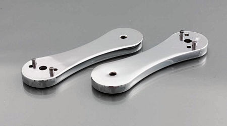

got my extensions finally made IMG_1250.JPG IMG_20170420_191704870.jpg IMG_1251.JPG
are these extensions available or were they made only for you? looking for a set and these would be just what I need?
RIVCO make them and can get from a lot of different providers including USA, UK and Oz.

Triumph Rocket III Passenger Board Pillion Relocation Arms
Oz
Optional Relocation Arms For The Triumph® Rocket III - Triumph Performance Parts Australia
Triumph Rocket III Passenger Board Relocation Arms Rivco TR3005-05
When saddlebags are installed on this model there is little or no room between the passenger peg and the saddlebag for the passengers heel. By moving the boards forward 4 you will gain the needed heel room as well as allow the passenger to be in a more relaxed seating position. The arms have two sets of alignment holes and can be installed at the original height or 1.5higher.

Them's pretty. I have something similar fitted that were made by Colin (aka Battersea) ages ago. Very solid as he made them in steel. His missus and mine are about the same size so I inherited them when he returned to Harleys.
