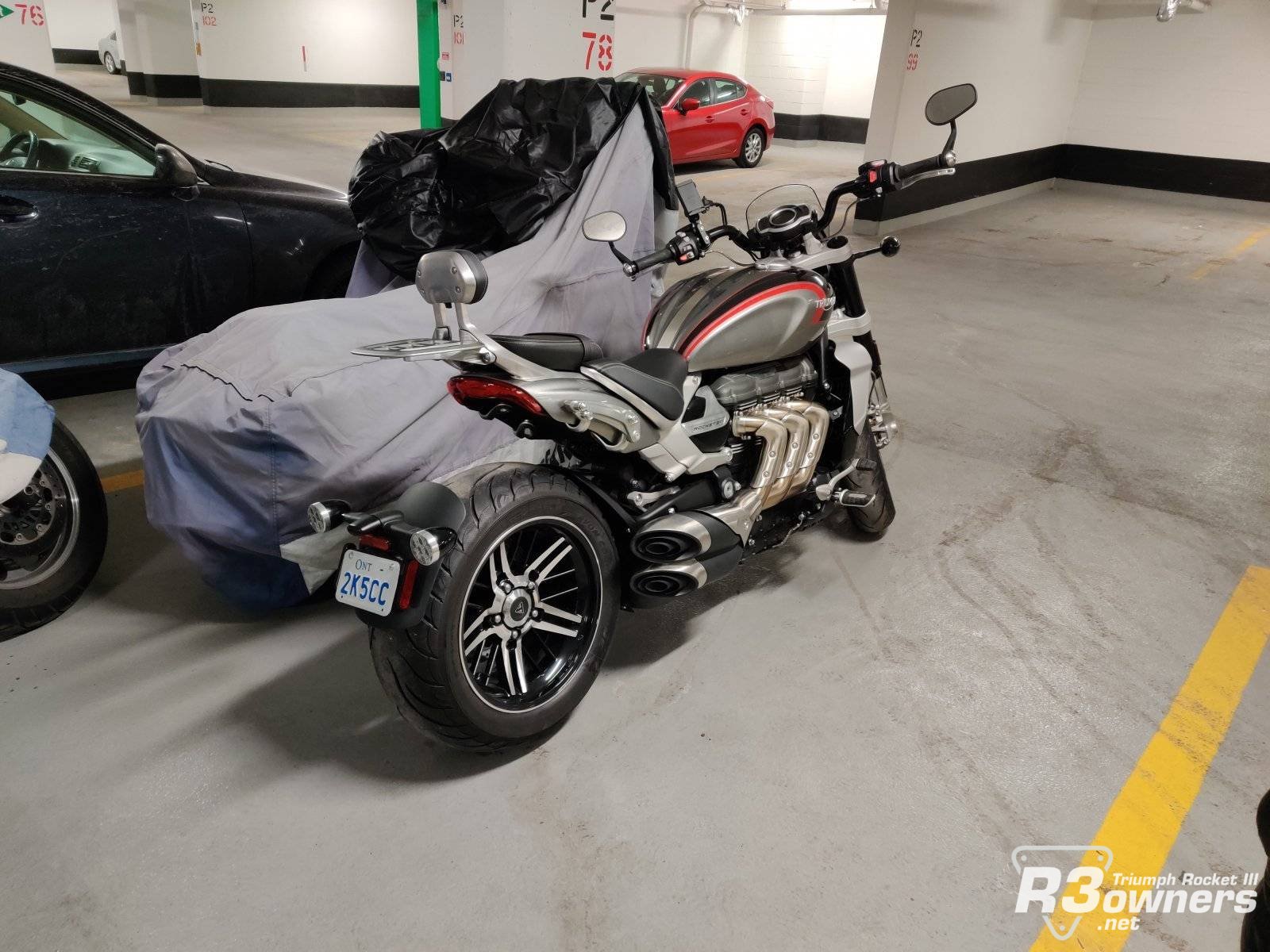

Definitely like the plate. We get only 5 characters in Ontario so needed to be creative. Old (2014 Rocket III Roadster) plate was RCK3T, new one is 2K5CC.
