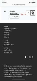

I think you are right, i may have one, i can check if you wont me too. Or this is from hermys
