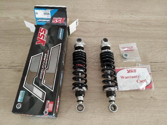

I want to mount better quality springs in the forks of my R3 Classic 2006, I want to know which is the best option and what you think about it: progressive springs or linear springs and why?
I bought a couple of rear shock absorbers from YSS and I want to improve the forks too, I don't have money for some cartridges. I almost always do routes on secondary roads with a passenger and I don't pass 120 km/h, sometimes I go out alone, I run more and I make more curves
These are the YSS rear shock absorbers
May I ask what series YSS shocks did you pick up?
