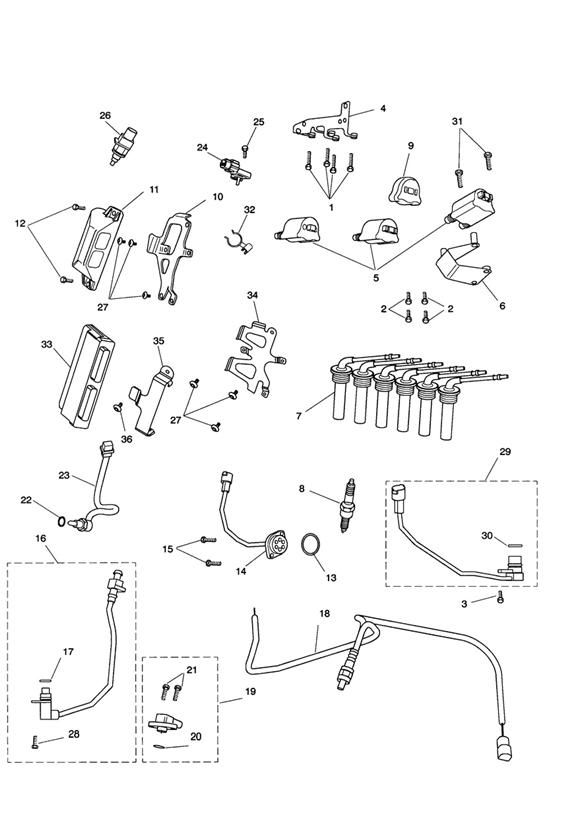

The ECU you bought (#33 below) fits only later Roadster models with ABS and their are 3 different Roadster ABS ECU variants which are matched to Roadster ABS specific ECU linked speedometer instruments and they cannot use aftermarket instruments.
Don't freak at the Aussie $ prices
T1290650 - ECM XC BASE​
  • Reference​
    33
  • Part Number​
    T1290650
  • Description​
    ECM XC BASE
  • Notes​
    Roadster Only
  • Price​
    1383.90
  • Qty On Diagram​
    1
  • Stock in Store​
    No Stock (Orders Available)
Your Classic has pre ABS instruments that are replaceable with aftermarket versions Dakota etc
If you have a 2008 classic you need the following ECU (#11 in image above)
T1299302 - ECU C20XB BASE​
  • Reference​
    11
  • Part Number​
    T1299302
  • Description​
    ECU C20XB BASE
  • Notes​
    Rocket III & Classic
  • Price​
    1474.10
  • Qty On Diagram​
    1
  • Stock in Store​
