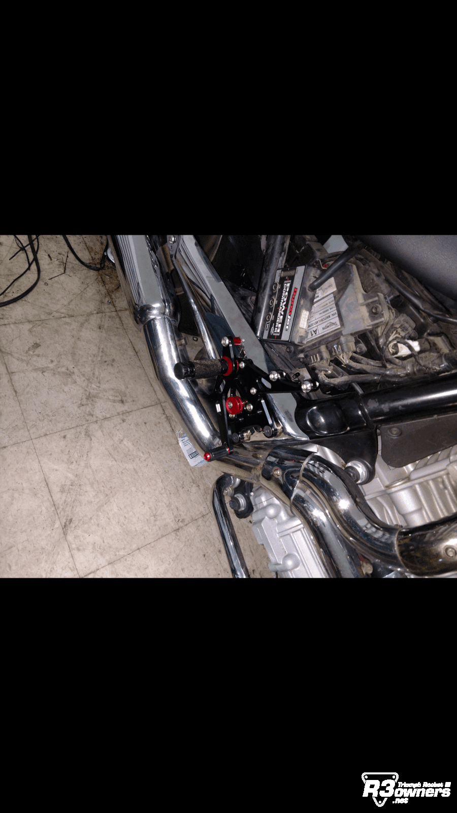

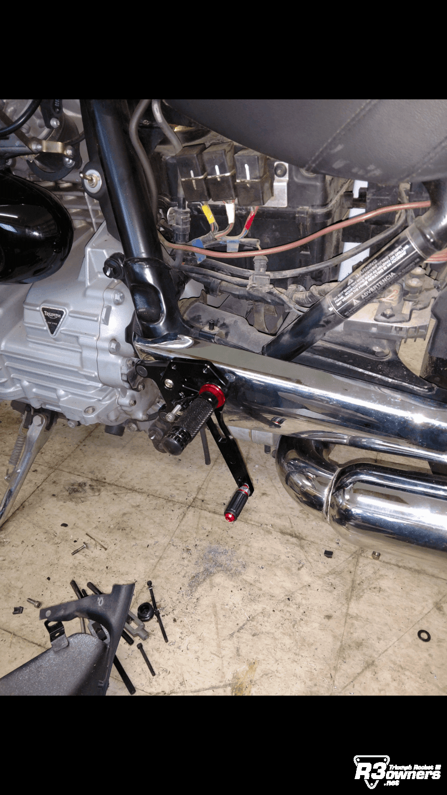

I know there's a couple people who have shown off their custom mid/rearsets, so I figured I'd show off mine so far.
I bought a set of 05-07 Triumph Speed triple rearsets off eBay for like $150. I drilled out the chrome covering and the screw hole and tapped for a 5/16 18-2-in black hex head bolt. I used flat washers to set it off the chrome cover a bit: 6 on the top and 9 on the bottom. The clutch linkage is going to be a length of all thread.
When they were bolted up I stood up on then and bounced a bit as I would prefer to test the strength not moving rather than riding down the road. My 210lbs didn't seem to stress them, everything held tight. Not professional looking, but I'm having fun with it so far. All in all with everything, I think I have $165 In it so far.
The clutch link I just need to cut down and that side will be done. The brake side I need to figure out how to rerun the lines to the new pedal.
