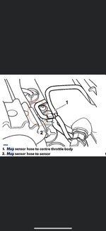

Sage1997 Standard Bore Joined Mar 27, 2021 Messages 3 Ride 2005 tr3 Mar 28, 2021 #1 I have a 05 and was changing spark plugs and noticed one of the map hoses loose it’s connected to the junction just can’t figure out where it connects to the throttle body at it is the one circled that runs under the air box Attachments E364990A-1770-4FB4-982B-ADC3773B25A0.jpeg 81.6 KB · Views: 20
R-III-R Turbo Mine is the biggest :) Joined Oct 12, 2010 Messages 2,227 Location Ireland Ride 2472cc Supercharged Carpenter Rocket III Stroker Mar 28, 2021 #2 Looks like the one that runs to a nipple on the rear most/ #3 cylinder throttle body. Upvote 0 Downvote
