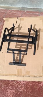

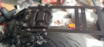

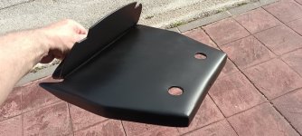

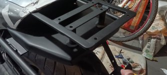

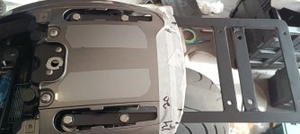

I made custom rack as that sissybar doesn't seem to be very strong and i need proper luggages. I searched all kind of luggages and ended up in Shad ones. Those were a bit bigger than thought and i wanted to put them as tight packet as possible and as low as possible too. I don't really like the look of rear luggage in any bike, but need one. I sacrificed that beautiful rear light too and put rear luggage support through it. You can put just straight bars/tubes over that rear plastic and keep original rear lamp. Covers to holes might be a bit tricky, but not impossible. Mine is a bit thin itself, but i have bolted them to side cases rack as very sturdy packet. That Shad SH58X has optional backrest cushions, so you don't really need that sissybar.
