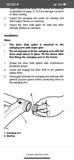

Got a 2014 Roadster and doing the 20k mile service. Does the forward splines in the driveshaft (part that goes to the engine)) need greasing? I have greased the splines which goes to the gearbox but never the engine side.
Kevin, those have never been removed or greased on the 2tone :oops::banghead:. I thought that they required no service.
I believe 1k9 is correct. That end of the shaft doesn't slide like the end at the rear end. Bevel box.
Lube drive shaft splineS, then fit driveshaft onto output shaft.
