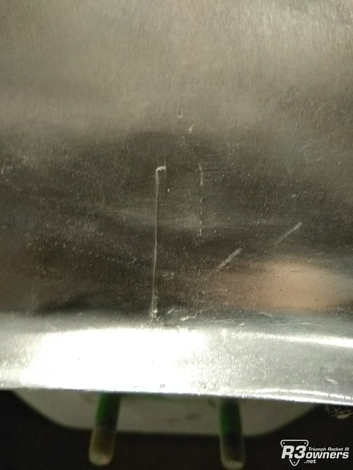

I just wanted to show you my gastank with crack. Picture is front center. Anyone seen something like it?
Front center, no aluminium. I´ll fix it, just curious if anyone else has had the same problem.
I do not recall anyone ever reporting a crack. Rusting thru from sitting until the bike was given away yes but cracks thankfully no.
I think its a bad weld from manufacturing. Its a very small leak, just made the paint bubble, no actual leak.
In days of old, they told me to run exhaust fumes through the tank while welding (from another vehicle). This eliminated the oxygen. Never tried it. Used a soldering gun, with the tank half full.
Flush the tank. Fill the tank with a inert gas such as argon. leave a small vent hole above the weld area. Then just weld it. I would not trust solder.
