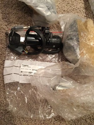

New Triumph Rocket 3 III Lock Set Ignition New Genuine T2500519 11
Au$195 plus $10 postage.
Hi Ishrab,
I have seen this one.
The plug is different from mine, but I've been told if I swap plugs it will work fine.
Trying to get confirmation of this?

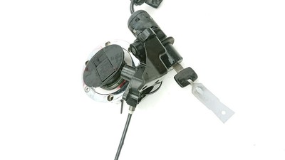

The correct one for your VERY, VERY, early series bike before VIN /Eng No. 343680 is T2501066.
Why not just the correct one from Triumph Australia?
Should not be too much more.
The plug will be different on the later mid 2006 VIN /Eng No. 3436801 onwards Standard, Classic and Roadster version T2501062 too.
