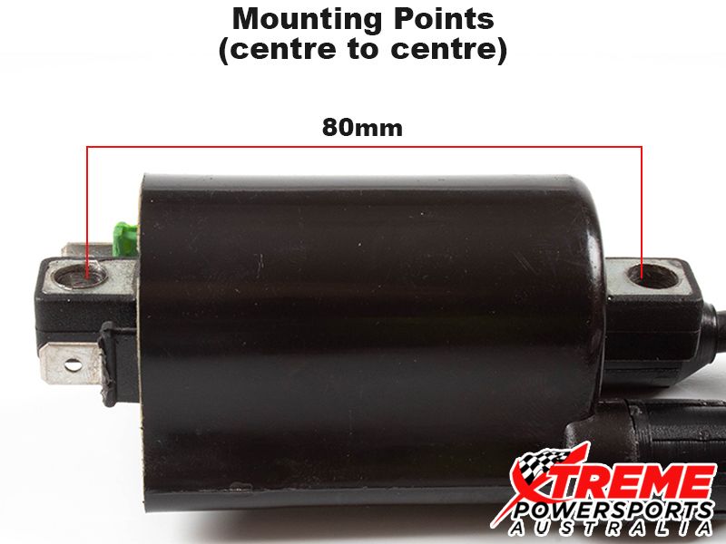

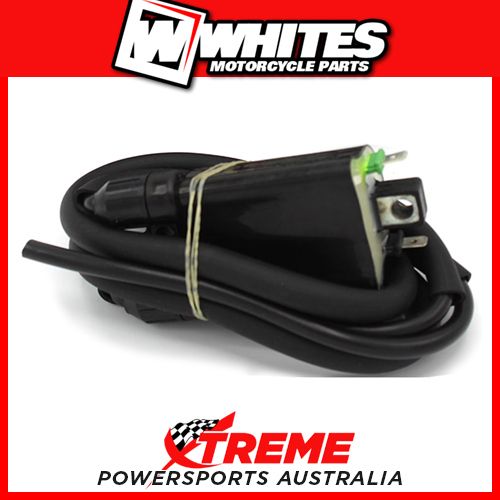

Whites Triumph Rocket III Roadster 2010-2014 CDI Ignition Coils WPELC04120207 | eBay
Whites
Description
Brand new aftermarket replacement ignition coil unit.
Specifications:
  • Voltage: 12V
  • Primary: 2.55 Ohm
  • Secondary: 23.20k Ohm
  • Holes Centres: 90mm
  • Leads: Twin
  • Suits: CDI

The seller of the Ebay Whites ignitioncoils emailed me back they don't deliver the sparkplugcaps too. However, I do need them too because of the disturbance.And Whitespowersports themselves don't give me any response to my question about their coils.So I do think the Ebayseller wants to get rid of his coils for 'some reason'.
