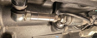

Sorry to resurrect this old thread, but I need to remove the gear shift lever on my 25 Storm GT (to take measurements to fabricate a heel/toe shifter) - but I have the TSA installed, so I can't remove the bolt you had marked with the red arrow (don't want to undo the TSA wiring).
Is it possible to just remove the 23Nm bolt and the 8Nm section right below that? I see there is a clip there on my rocket - but can't seem to figure out how to remove that to free up the shift lever.
Any guidance?
Any guidance?
It sure looks like you could, but I don't know how that might affect the settings on the TSA. If it weren't a dealer only install I would say to go for it, but wondering if undoing it might affect the settings somehow.
If you do, I would mark where everything is currently adjusted with a sharpie so that it can get it back like it was. I'll bet someone who really knows will chime in shortly....
