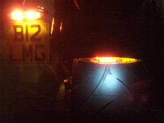

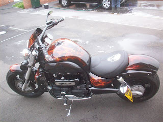

Yep - my plates on the side. I have a rear/brake light mounted on the plate and combi rear/brake/indicator unit mounted under the rear mudguard (which has been cut down). Like this:

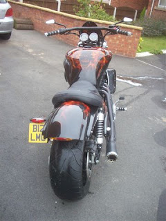

The wire for the side plate runs down the back of the bracket and then behind the metal work where the pillion peg is mounted. You can just about see here:
The bracket I got is from Germany and was really for a Honda but since it would fit, had a rear light mounted quite neatly on it, and (most importantly) was in black I went with that. Its mounted on the Pillion footrest mounting point (I dont take pillions on the Rocket), and yes - just tapped in to the wiring loom. Owl has and I did have a custom dynamics custom LED array mounted on the rear mudguard acting as rear/brake/indicators allowing just a basic light for the plate.
