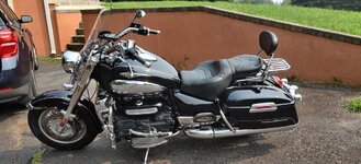

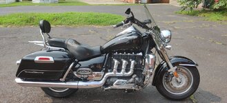

New to me 3 months ago, Looking for more power got got 20368.hex installed, Seem's rich, just adjusted TPS, and Secondary TPS, and Idle stepper motor, sprayed some cleaners in map sensor, and TB cleaning, and ran fuel injector cleaner thru 18 gal's of gas 1oz/gallon at a time, runs fine, just doesn't seem to have the power a 2.3L motor should, won't break the tire loose without dropping the clutch, didn't try that yet, not that I want to, just thought that big of a motor would.

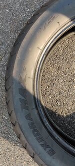

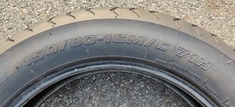

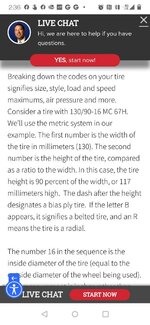

When I was looking I googled what's the biggest production motor made and it showed me the Rocket on YouTube going 150mph from 55 pulling away from a Hayabusa, so I thought cool, then I looked for a used one and there weren't too many out there, came up with the R3T, at first I was looking for any cruiser with the bag's and all BMW, Honda, HD,Kaw, Glad I found this, found out a lot of info in here, like the recall on Bridgestone Exedra Max tire's in 09' on the touring, the guy who sold me the bike gave me a Bias Exedra tire for the front it already had that tire in radial on the back, so I called Bridgestone and they told me they don't make a tire for that bike, I didn't ask any questions and he didn't offer any answers, also when I was looking for a tire online the only tire for the rear size in Bridgestone is a radial, the guy already had a worn out Metzeler Bias me888 on the front and the radial on the back, not good to mix those, I wouldn't even mix manufacturers, I thought it felt a little weird on the test drive, then once I got it home and got it on the road, NJ DMV S**** I found out it had 22psi in the front and 26psi in the rear!!!, Rode a lot better with the right pressure, I put 36 front and 42 rear, ride's like a dream now, I even asked the guy if he felt a wobble going around corners and I only took it up to 45mph. GL
