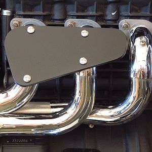

I love my Viking pipes but like all custom pipes they tend to turn your your right leg into a bratwurst that's been forgotten on the barbe... even more of a problem in Las Vegas temperatures above 40C... So, I made several patterns and had a guy make brackets, cut, bend and weld them on to a piece of stainless.
My original instructions were for him to radius bend the shield, but he did sharp bends, which don't look as good and don't really match the lines of the bike.. we had a disagreement. Anyway, I got the shield, powdercoated it black and put it on. Wow! This makes such a HUGE difference. I can sit at a light, ride slowly or cruise the twisties in the heat.. my leg intact and shoe un-melted.
If you look closely, we bent the shield below the pipe and above it, plus the guy welded pieces on the front and the back (hard to see) to keep heat in.
As much as I'd love to keep those beautiful pipes exposed and visible, this is ride-able and I really like my leg more than being pretty... It is an amazing difference.
Nah, I couldn't do it if I had Viking headers. If you need them, much smaller and following pipe should suffice and maintain the look.
But as you say if 40C regularly in traffic I would have a heat shield of some sort.

I can understand the shield - I made one up too (though I don't have Paul's pipes) - I was pissed of with pants melting onto them.
Though proper 100% aramid lined jeans work well too. But not sure that bending the edges over is that clever. I would want some airflow over the steel pipes.
I am a firm believer in Heat shields, That being said I would have gone with something that follows the line of the headers more. Its not cheap I remember kicking the cash out for two sets to fit the carpenter pipe. Totally worth it IMO. I wish the pipe make for the Carpenter pipe would make some I'd pay. Mine came from Oz :D
So @mully95 and I both have Viking headers, and he turned me on to a small heat shield and I really like it.
I found some generic ones that fit well.
