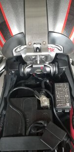

view from the bottom of that bolt:
Looks like you just need to remove that bolt that it's in the bottom of the tank securing the strap. Looks allen. Once you remove that the strap should be free. I don't think you need to remove the tank, just the seat
